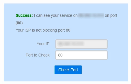

I’m trying to set up a site using my new SurfBoard G18 with XAMPP.  I was able to successfully open port 80 to outside traffic -- and verified that these ports were open with canyouseeme.org (see image) -- and ran the Apache web server, only to be met with repeated connection timeouts every time I attempted to connect to my external IP address.

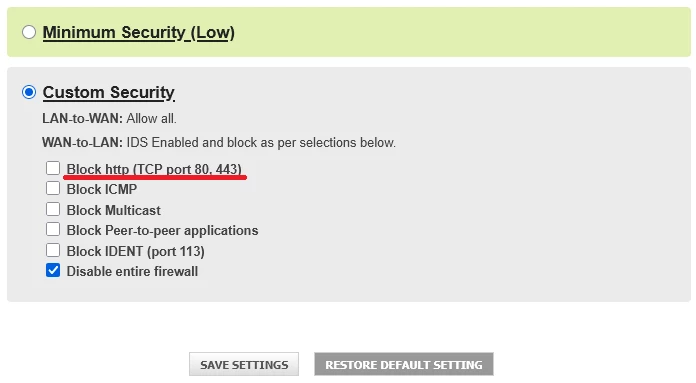

I poked some more around my router settings and found that certain security levels found in the Firewall settings would block or at least threaten to block HTTP ports (though I’m not sure this was part of the problem). I turned the router’s firewall off just in case. There were no changes and I still only got timeouts trying to use port 80.
