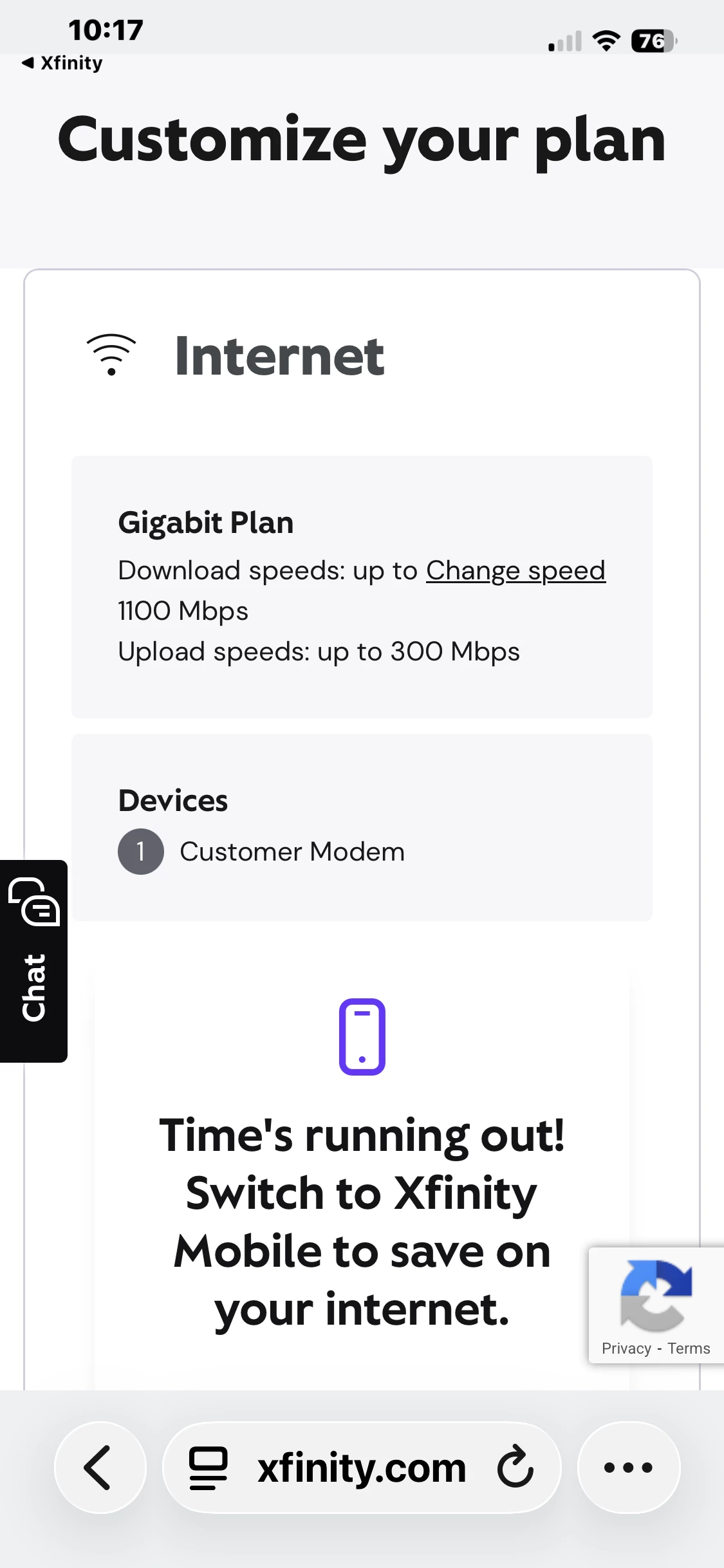

Xfinity. It does not reboot on its own it stays a constant blue light. The only way it reboots is if I unplugged it for 30 seconds. the app doesn’t even restart it. Everything drops my TV takes the longest because it’s hardwired to the modem, but our phones and other streaming sticks drop right away.
