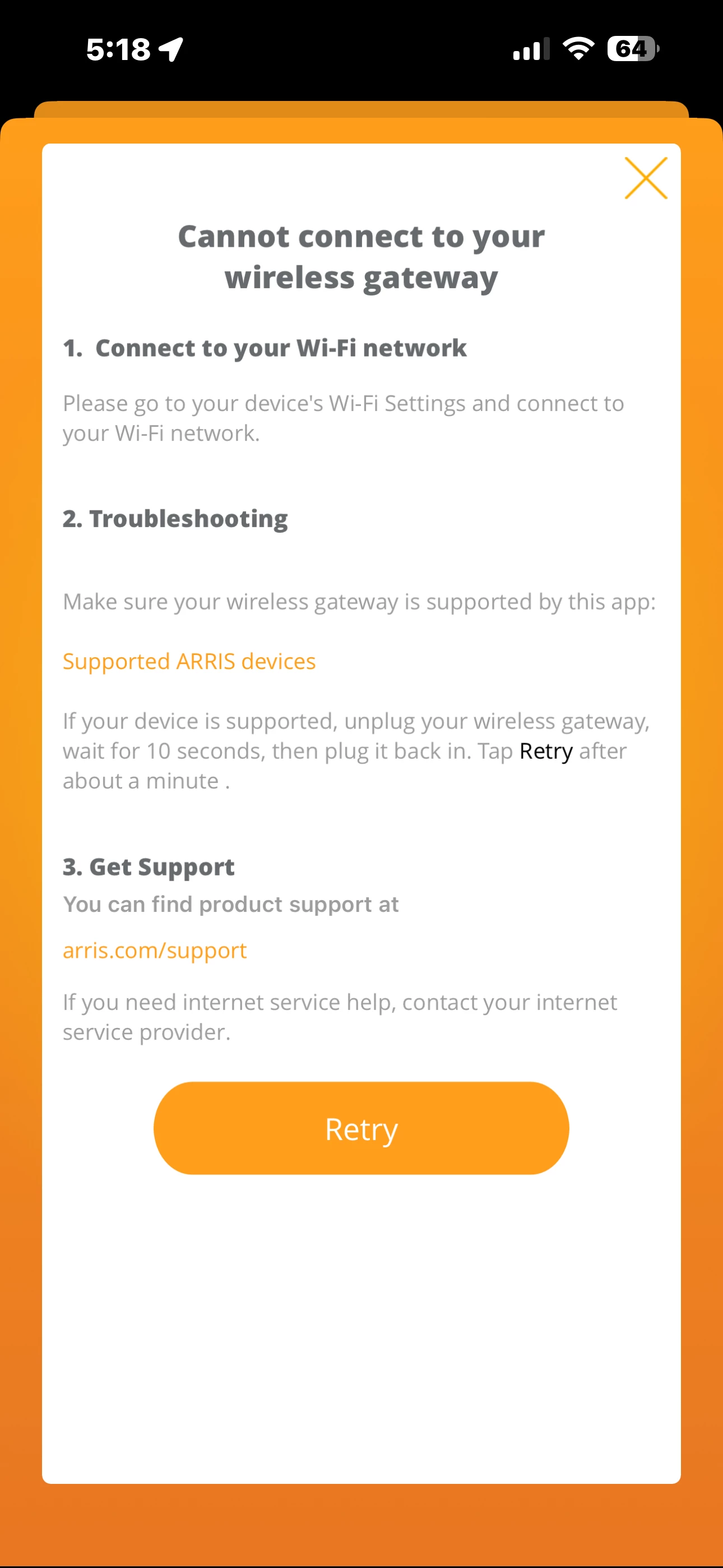

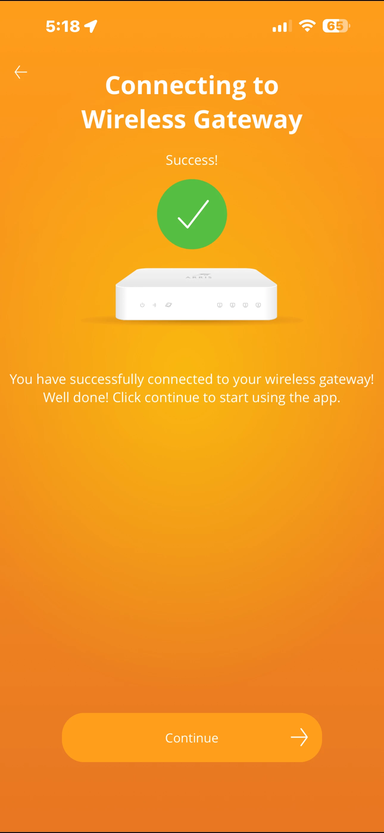

My internet goes out randomly and multiple times a day. The internet company checked and everything is fine on their end. I’ve factory reset the surfboard g34 and the internet works but still crashes and the app is telling me it cannot connect to the gateway after it told me it successfully did.
The app you are currently using is SURFboard Manager, which is an older version. If you follow the instructions carefully, you will find that the updated app is called SURFboard Central.
