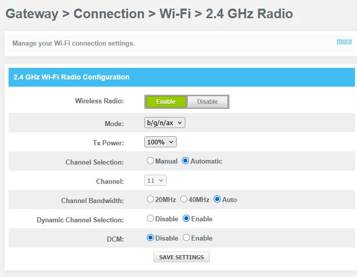

What settings besides WPA2 security mode should be changed on the Split 2.4GHz SSID (and for the 3 other Split Primary SSID's)? In Gateway>Connection>WiFi>2.4GHZ Radio (on the Primary SSID before Splitting), there are settings for Mode, Tx Power, Channel Selection, Channel, Channel Bandwidth, Dynamic Channel Selection and DCM. See Screenshot below. What would you recommend for each of those settings on the 2.4GHz SSID and the other 3 SSID's?
Your assistance is appreciated. Best wishes.
Most IoT devices perform best when the 2.4 GHz encryption method is set to medium. Changing the security mode is the recommended approach; however, this does not affect the complexity of the Wi-Fi password.
Apart from adjusting the security mode, no other changes are required in the 2.4 GHz radio settings.
