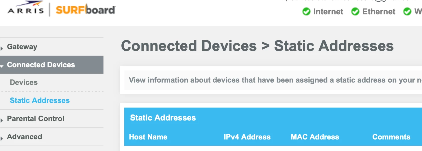

i’m getting an error that says (title) and I have 25 devices already added.
is 25 the cap? (i doubt it) anyway, I’d appreciate some assistance. thanks.
When setting a static IP address, it's important to use the correct IP range.
For example, if your G54 gateway’s IP address begins with 192.168.0.xxx, then your static IP must follow the same sequence.
Using a different range—such as 192.168.1.xxx or anything outside 192.168.0.xxx—will result in the configuration being rejected by the gateway.
Could you please help us with the product’s model number? Also, could you confirm whether you're trying to assign a static IP address to the device?
  • August 22, 2025
yes, I am attempting static IP addresses for my devices.
the name of the device is arris surfboard wifi modem G54
another thing is, my download speed is 2.1gbps and “connected devices” takes at least 90 seconds to load.
