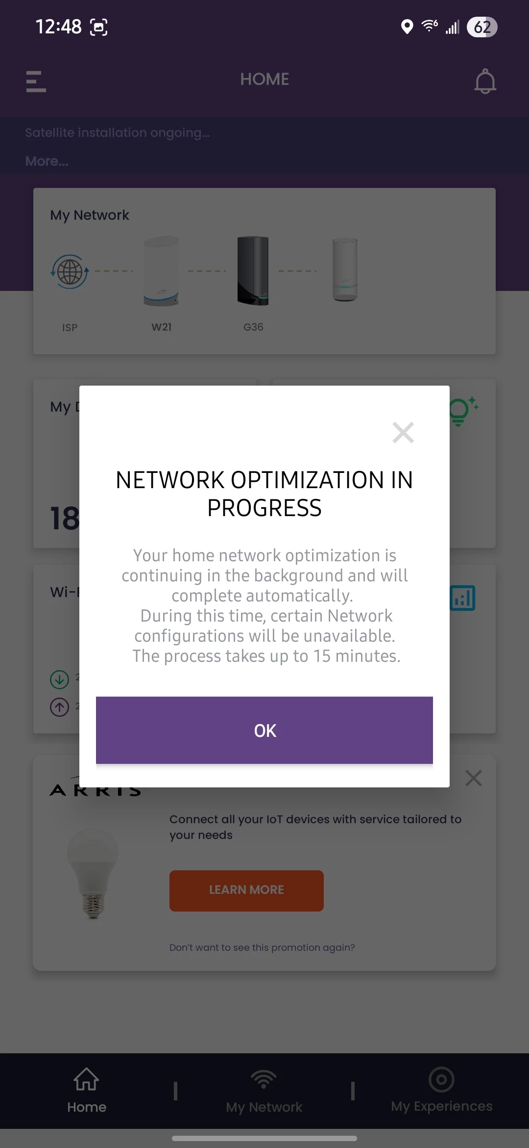

Just got the w122 mesh system with the w11 satellite. I got the main router to work but can't get the satellite to work. It goes through the whole process, says its been added and that it will start a network optimization and that it will take 15 minutes but then about a half hour later I get this screen. So I try restarting my modem, restarting my router, and factory resetting my satellite and starting over and have tried atleast 10 times on a galaxy s24 and an iPhone 15 (both on their latest firmware and uninstalled/reinstalled the surfboard central app) and always get the same thing.

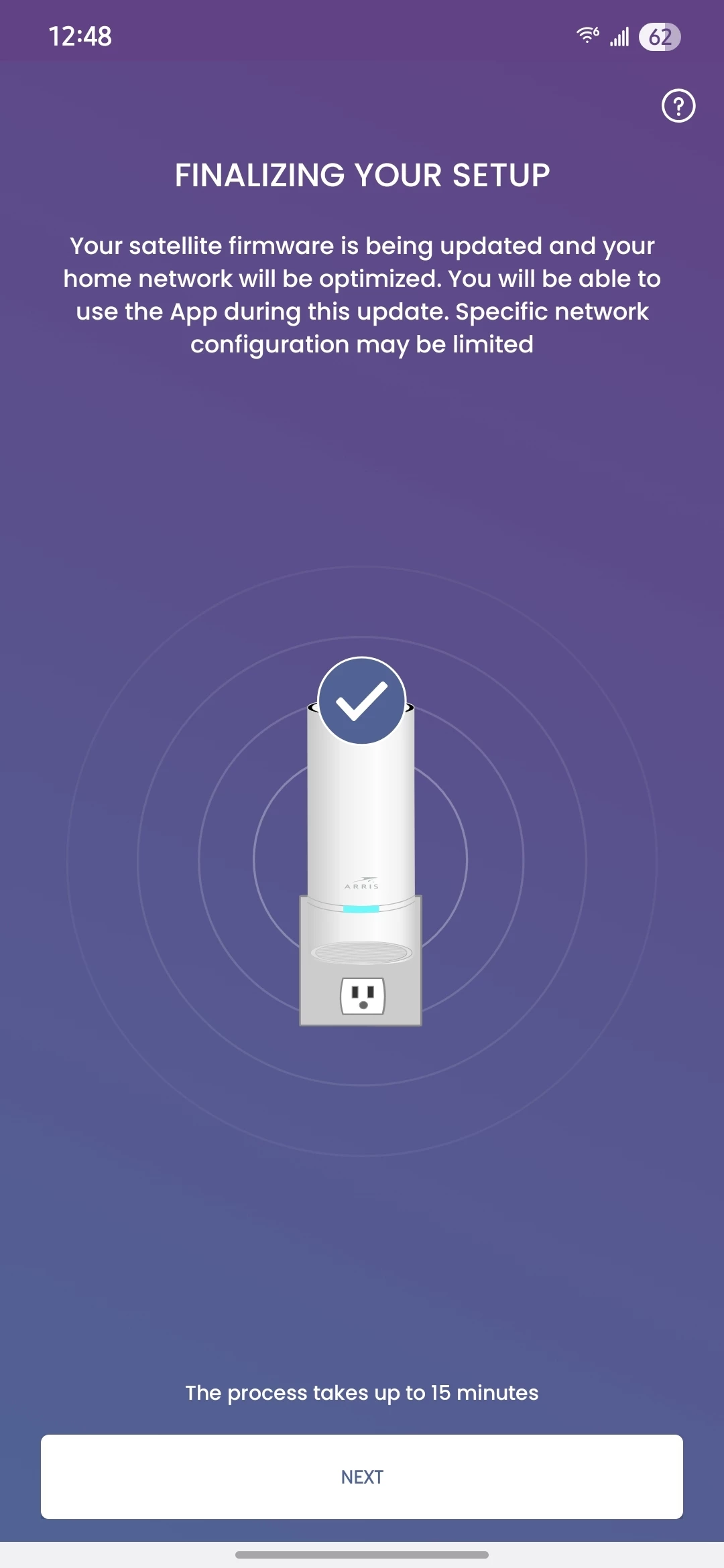

Thank you for the response. I did try a few extra times with the notes you gave me but I am still not having any luck. The light on the router is blue during the whole process. The light on the extender starts with a white and green blinking light and eventually switches to a slower white and green blinking light once I see the "connection successful" screen. I've attached 2 screenshot of what I see after the extender is added and before I get the screen shown in the original post. It seems as if it going through properly and adding the extender but then something goes wrong with the network optimization and then it deletes it off my network.
