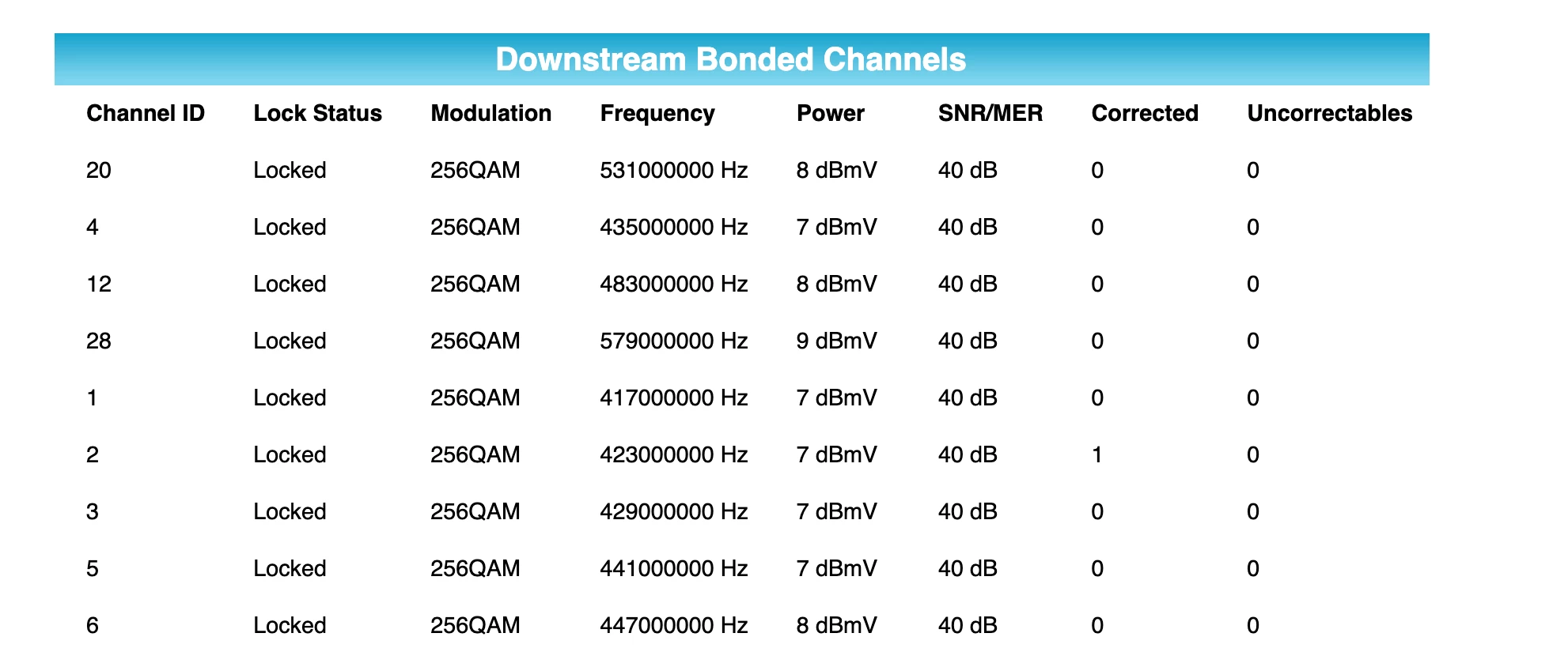

I performed the checks and my Downstream power is between 6-9 but once jumped to 15, which seems to be the upper range.
My downstream Bonded channel is QAM256, except one spot it said OFDM PLC. the OFDM PLC coincided with the higher 14 power.
In general, the channel is QAM256. and the power > 0 so the SNR > 30 and it is. It is 40.
So all these thngs seem to be in line? Again, the resets are 3-4 times a day. If I do contact my ISP, I wouldn’t know what to tell them

The troubleshooting. numbers all look good, but your modem is still resetting numerous times a day.
Could you please recheck the upstream power levels and confirm whether they fall within the acceptable range?

All the upstream are exactly 45. I had the comcast XFinity tech come out and he replaced all the lines and connections, and it seems to be fixed now
